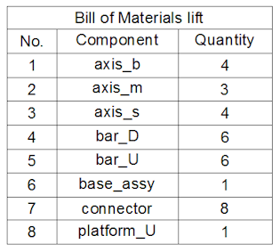

Creates a BOM of the top level components only.

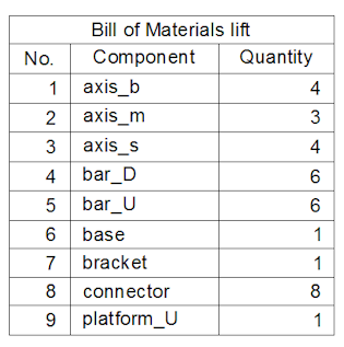

Creates a BOM of the subcomponents.
Compared to the Top Level BOM, the base_assy component is broken up into the base and bracket components.

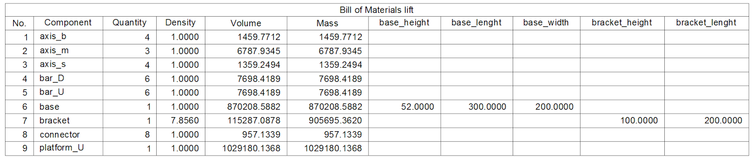

Allows to add additional columns to your BOM table: Description, Density, Volume, Mass, Material, Thickness and Parameters (for parametric components). Prompts you: Toggle columns [Description/dEnsity/Volume/Mass/parameterS/mAterials/Thickness/Back] <Back>: Choose an option:
BOM with Densitiy, Volume, Mass and Parameters
