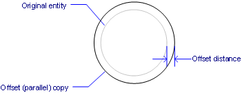

Distance
Specifies the distance between the original entity and its parallel copy.
Do one of the following to specify the distance:
  • Press Enter to accept the current distance.
  • Type a value.
  • Specify two points in the drawing.
The offset distance is saved to the OFFSETDIST system variable.

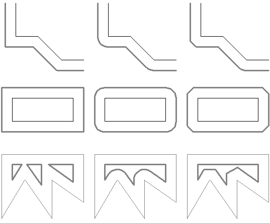

OFFSETGAPTYPE
The OFFSETGAPTYPE settings variable specifies how possible gaps are filled when offsetting polylines.
Left: OFFSETGAPTYPE=0: polyline segments are extended to close gaps
Middle: OFFSETGAPTYPE=1: filleted gaps (the radius of the arc segments equals the offset distance)
Right: OFFSETGAPTYPE=2: chamfered gaps (the perpendicular distance to the chamfers equals the offset distance)
