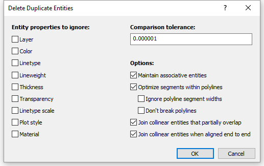

Deletes duplicate entities and overlapping lines, arcs or polylines and unifies partly overlapping or contiguous ones.
command bar: overkill
: overkill
Select entities: (Compose a selection set, then press Enter.)
Entity properties to ignore |
Selected properties are ignored when comparing duplicate or overlapping entities. |
Comparison tolerance |
Sets the tolerance for the comparison process. If set to 0 (zero), entities must match completely before being evaluated in the overkill process. |
Options |
