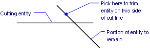

Choose one or more entities to act as cut lines, including text. These entities define where crossing entities are trimmed. Select one or more entities using any selection method. |
Selects all entities in the drawing, except for those on frozen layers. Press Enter to select all. Note that entities can both define cutlines and be cut. |
Chooses the entity to be trimmed. Select a single entity; only one entity can be trimmed at a time. Your pick point defines the portion of the entity to be removed.

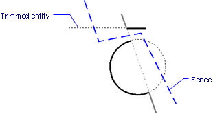

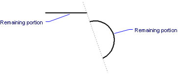

Cuts entities interactively; prompts you: First point of fence - specify the fence's starting point. Next fence point - specify the next point; press Enter to exit this option. As you pick fence points in the drawing, BricsCAD immediately trims entities under the fence. The portion of each entity between other entities is trimmed:
