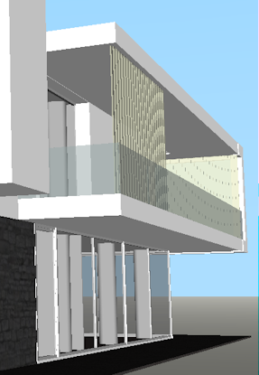

Displays drawings in flat rendered mode. Facets are not smoothed. This is the mode used by the Shade command.
Displays drawings in Gouraud rendered mode. Facets are smoothed. |
Displays drawings in flat rendered mode, with edges outlined in the background color. |
Displays drawings in Gouraud rendered mode, with edges outlined in the background color. |
