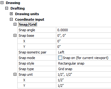

Right-click SNAP on the status bar for the shortcut menu:
Shortcut Menu |
On |
Turns on snap. |
Off |
Turns off snap. |
Settings |
Opens the Snap/Grid section of the Settings dialog box.
Snap angle |
Sets the angle of the snap in the current UCS. Also affects the angle of the grid display and ortho mode. |
Snap base |
Specifies the x,y-coordinates about which the snap rotates. Also affects the angle of the grid display and ortho mode. |
Snap isometric pair |
Specifies the isometric plane; click the droplist and choose one:
This setting requires Snap Style to be set to Isometric Snap. |
Snap mode |
Toggles snap mode:
Snap style |
Specifies the snap style; click the droplist and choose one:
Snap type |
Specifies the snap type; click the droplist and choose one:
Snap unit |
Specifies the snap increment distance:
