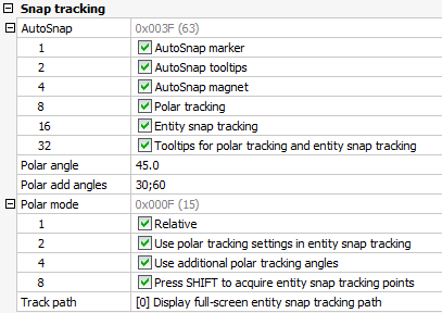

Adjust the settings:
1: Autosnap marker (not used, required for AutoCad® compatibility only)
2: Autosnap tooltips (not used, required for AutoCad® compatibility only)
4: Autosnap magnet (not used, required for AutoCad® compatibility only)
8: If checked, Polar Tracking is on.
16: If checked, Object Snap Tracking is on.
32: If checked, tooltips display for polar tracking and entity snap tracking.
Polar angle: Sets the polar angle increment.
Polar add angles: Sets the additional polar angles. Separate angles by semicolons.
1: If checked, polar angles are measured relatively from selected entities.
2: If checked, the polar angles (interval and additional angles) are also used in entity snap tracking.
4: If checked, the additional angles for polar tracking are used.
8: If checked, press and hold the Shift key to acquire entity tracking points.
