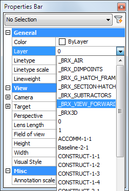

Setting the current layer
Do one of the following:
Choose a layer in the drop down list.
- On the Entity
Properties toolbar, click the down arrow next to the
Layer field, then choose a layer in
the drop down list.
- Right click on the Layer field in the
Status Bar, then choose a layer in the context menu.
