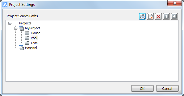

Creating projects
To create a project:
  1. Open the Project settings.
  2. Click the Browse button at the right hand side of the Project search paths settings field.
    The Project Settings dialog opens.
  3. To create the first project:
  1. To create additional projects.
  2. Click Projects (on top of the projects tree) then click the New button () .
  3. Type a name to replace the NewProject1 default name.

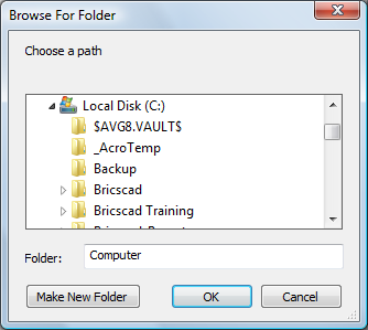

Adding search paths to a project
To add a search path to a project:
  2. Select the project in the Projects tree.
  3. Click the Browse button ().
    The Browse for folder dialog opens.
  4. Do one of the following:
  1. Click the OK button to add the selected folder to the project search paths.
Changing the order of the search paths
  2. Click the expand button (+) of the project you want to edit.
  3. Select a search path, then click the up () or down () buttons to change the order of the search paths.
