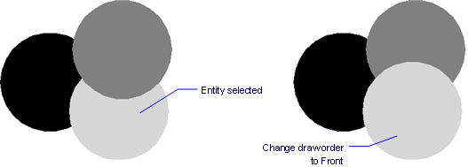

The last created entity is displayed on top of one created earlier.
Front
Moves the entities' display order above all other entities.
Back
Moves the entities' display order below all other entities.
