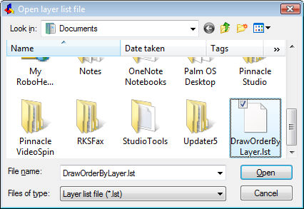

Choose a LST layer list file, and then click Open.
The file must be created by user. The LST file is an ASCII text file that contains a list of layer names in the following format:
LayerName1
LayerName2
LayerNameN
Wildcard characters are supported in layer names.
The DrawOrderByLayer command places entities on the layer 'LayerName2' in front of entities on the layer 'LayerName1', the layer 'LayerName3' in front of the 'LayerName2' and so on. Missing layers are skipped.
