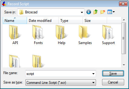

: recscript
Specify a file name, and then click Save.
Enter drawing and editing commands, and pick points in the drawing.
When done, enter the StopScript command.
