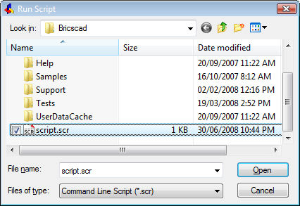

Select an SCR file, and then click Open. The script begins running immediately.
To rerun the script, use the RScript command. For more information on writing scripts, see Customizing Bricscad.
Look in
Chooses the drive and folder name.
File name
Specifies the name of the SCR file.
Open
Opens the SCR file, and then runs the script.
