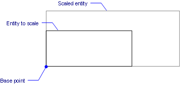

Chooses the entities to be resized. Use any selection method. |
Specifies the base point. This is the point from which the entities "grow" or "shrink." Pick a point in the drawing, or enter x,y,z coordinates. Use entity snap to pick a geometric feature accurately. |
Specifies the scale factor:
Resizes entities using a relative scale factor; prompts you: Base scale - enter a scale factor or pick two points. New scale - enter the new scale factor. Use this option to scale entities relative to other entities. For example, pick two points on an existing entity. When you pick two points, Bricscad prompts you: Second point - pick another point. |
