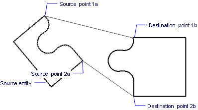

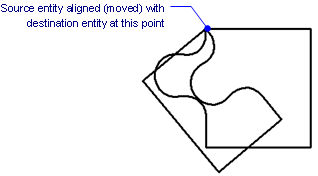

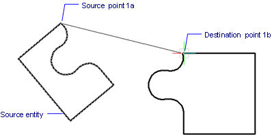

To move entities, specify one pair of source and destination points to move entities:
Specify first source point
Specifies the source alignment point, such as #1a in the figure above.
Specify first destination point
Specifies the destination alignment point, such as #1b in the figure.

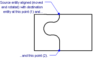

To move and rotate entities, specify a second pair of source and destination points to move and rotate entities:
Specify second source point
Specifies the second source alignment point, such as #2a in the figure above.
If you press Enter at this prompt, the source object moves.
Specify second destination point
Specifies the matching destination point, such as #2b in the figure.
To move and rotate 3D entities, specify a third pair of source and destination points to move and rotate 3D entities.
Specify third source point
Specifies the source point for 3D alignment; press Enter to move and rotate 2D entities.
Specify third destination point
Specifies the matching destination point.
