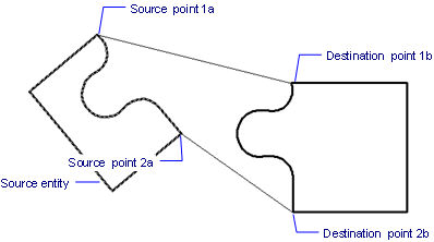

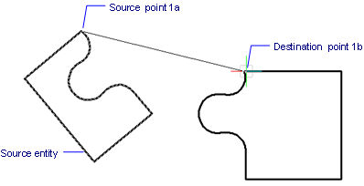

Specify first source point: (Pick a point on or near the source entity.)
Specify first destination point: (Pick the matching point on or near the destination entity.)
Specify second source point: (Pick another point on or near the source entity.)
Specify second destination point: (Pick the matching point on or near the destination entity.)
Specify third source point: (Press Enter for 2D entities; pick source and destination points for 3D alignment.)
Scale objects based on alignment points [Yes/No] <No>: (Enter Y or N.)
Specifies the entities that are to be aligned; do not select destination entities; otherwise they are also move. |

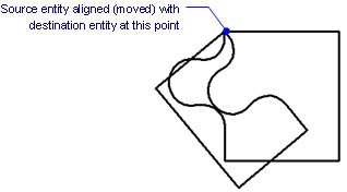

To move entities, specify one pair of source and destination points to move entities:
Specifies the source alignment point, such as #1a in the figure above. |
Specifies the destination alignment point, such as #1b in the figure. |

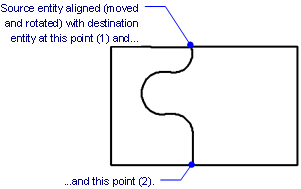

To move and rotate entities, specify a second pair of source and destination points to move and rotate entities:
Specifies the second source alignment point, such as #2a in the figure above. If you press Enter at this prompt, the source object moves. |
Specifies the matching destination point, such as #2b in the figure. |
