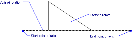

Chooses the entities to be rotated. You can choose one or more entities using any entity selection method. Press Enter to end entity selection. |
Specifies the start point of the axis of rotation. |
Specifies the endpoint of the axis of rotation. |
