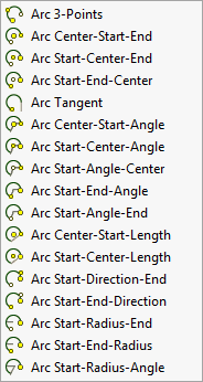

This command draws arcs by 17 methods. You can see the full list in the Draw | Arc menu:
and the Arcs toolbar:

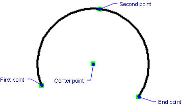

Second point
Specifies a point along the arc's circumference; following this, you specify the following:
  • Endpoint.
