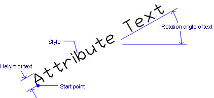

Text
Specifies the style and justification of the text:
  • Style specifies the text style; enter the name of a style present in the drawing.
  • Align aligns the text between two points; the text height is adjusted to maintain its aspect ratio.
  • Fit aligns the text between two points; the text height is maintained.
  • Center centers the text's baseline on the pick point.
  • Middle centers the text on the pick point.
  • Right right justifies the text.
  • Justify accesses additional justification options.
  • Start point left justifies the text.
Height of text
Specifies the height of the attribute text, unless overridden by the text style or justification. Enter a value, or pick two points to indicate the height.
Rotation angle of text
Specifies the rotation angle of the rotation text. Enter a value, or pick two points to indicate the angle relative to the positive x axis.
