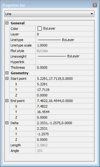

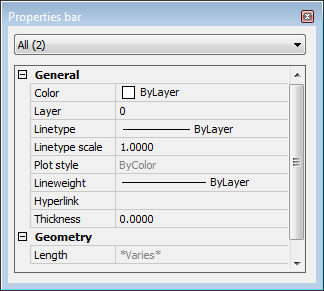

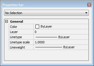

Displays a palette with varying content:
Options
Color
Reports the current color. To change the color of selected entities:
  1. Click the droplist and then choose another color.
  2. Choose Select Color to access the Colors dialog box.
 See Color command.
Layer
Reports the current layer name. To change the layer of selected entities:
  1. Click the droplist, and then choose another name.
See Layer command.
Linetype
Reports the current linetype. To change the linetype of selected entities:
1. Click the droplist. and then choose another name.
2. Choose Load to access the Load Linetypes dialog box.
See Linetype command.
Linetype Scale
Reports the current linetype scale factor.
To change the linetype scale, enter a new value. See LtScale command,
Plot Style
Reports the current plot style. To change the plot style of selected entities:
  1. Click the droplist and then choose another name.
(This property is available only when plot styles are enabled for the drawing. See PlotStyle command.)
Lineweight
Reports the current lineweight. To change the lineweight of selected entities:
  1. Click the droplist and then choose another width.
See LWeight command.
Hyperlink
Reports the current hyperlink. To change the hyperlink of selected entities:
1. Enter a new URL.
2. Click the button to access the Edit Hyperlinks dialog box.
See Hyperlink command.
Thickness
Reports the current entity thickness. To change the thickness of selected entities:
  1. Enter a new value.
See Elev command.
Other properties vary, depending on the entity selected.
