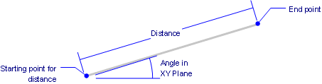

Reports the distance and angle between two points.
command bar: dist
transparent: 'dist
alias: di
menu bar: Tools | Inquiry | Distance
toolbar: Inquiry | ![]()
: dist
Starting point for distance: (Pick a point, or enter coordinates.)
End point: (Pick another point, or enter coordinates.)
Sample response:
Distance = 4.3167, Angle in XY Plane = 220, Angle from XY Plane = 0
Delta X = -3.3302, Delta Y = -2.7466, Delta Z = 0.0000
