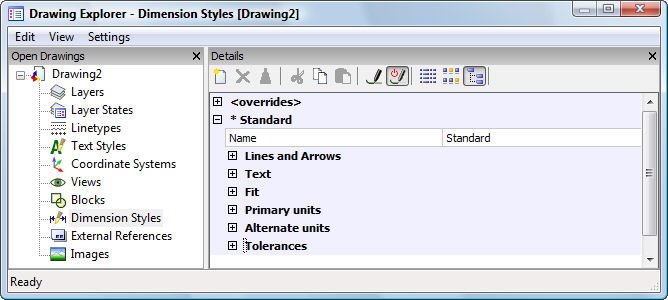

Displays the Drawing Explorer at the Dimension Styles section:
Create or edit dimension styles, and then click X.
Press F1 to access help.

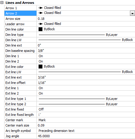

Arrow 1
Specifies the style of arrowhead for the starting end of the dimension line; choose from one of the following types:
Arrow 2
Specifies the style of arrowhead for the other end of the dimension line.
Arrow Size
Specifies the length of the arrowhead; the width is scaled proportionately.
Leader Arrow
Specifies the style of arrowhead for the starting end of the leader line.
Dim Line Color
Specifies the color of the dimension line; choose from:
  • Any Index Color.
  • Any True Color.
  • ByBlock.
  • ByLayer.
Dim Line type
Specifies the line type of the dimension line; choose from any line type loaded into the current drawing.
To access additional linetypes, click Load, and then choose one from the Load Linetypes dialog box.
Dim Line LW
Specifies the lineweight of the dimension line; choose from any lineweight supported by Bricscad.
Dim Line Ext
Specifies the distance that the dimension line extends beyond the extension lines.
Dim Baseline Spacing
Specifies the default distance between dimensions added with the DimBaseline command.
Dim Line 1
Toggles the display of the first half of the dimension line (between the starting extension line and the text).
Dim Line 2
Toggles the display of the second half of the dimension line (between the other extension line and the text).
Ext Line Color
  • Any Index Color.
  • Any True Color.
  • ByBlock.
  • ByLayer.
Ext Line type
Specifies the line type of both extension lines; choose from any line type loaded into the current drawing.
Ext Line LW
Specifies the lineweight of the extension line; choose from any lineweight supported by Bricscad.
Ext Line Ext
Specifies the distance that the extension lines extend beyond the dimension line.
Ext Line Offset
Specifies the offset distance between the object and the start of the extension lines.
Ext Line 1
Toggles the display of the first extension line.
Ext Line 2
Toggles the display of the second extension line.
Ext line type 1
Specifies the line type of the first extension line; choose from any line type loaded into the current drawing.
Ext line type 2
Specifies the line type of the second extension line; choose from any line type loaded into the current drawing.
Ext line fixed length
Specifies the length of fixed-length extension lines.

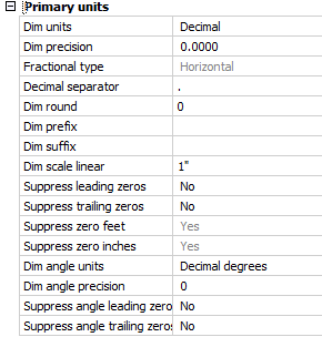

Dim Units
Specifies the display units for dimensions:
  • Scientific -  scientific notation, such as 1.2345E+01.
  • Decimal - metric, such as 1.2345.
  • Engineering - feet and decimal inches, such as 1'-2.3456".
  • Architectural - feet and fractional inches, such as 1'-2 1/16".
  • Fractional - fractional inches only; no feet, such as 14 1/16".
  • Windows Desktop - uses the units set by Windows.
Dim Precision
Specifies the precision of units, either decimal places or fractional accuracy.
Fractional Type
Specifies how fractions are stacked:
  • Horizontal - stacks fractions vertically, with a horizontal separator line.
  • Diagonal - stack stacks diagonally, with a diagonal separator line.
  • None - does not stack fractions, placed horizontally with a slash separator.
Decimal Separator
Specifies the character used to indicate the decimal point; can be any character.
North American countries use the period; European countries use the comma.
Dim Round
Specifies the rounding of decimal numbers; range is none to 8 decimal places.
Dim Prefix
Specifies prefix text that appears in front of the dimension text, if any.
Dim Suffix
Specifies suffix text that appears after the dimension text, if any.
Dim Scale Linear
Specifies the multiplier for dimension values, such as 25.4 for changing inches to millimeters.
Suppress Leading Zeros
Toggles the display of zeros in front of the decimal point; for example, 0.23 is displayed as:
  • On - .23
  • Off - 0.23
Suppress Trailing Zeros
Toggles the display of zeros in front of the decimal point; for example, 1.2300 is displayed as:
  • On - 1.23
  • Off - 1.2300
Suppress Zero Feet
Toggles the display of zero feet; for example, 0'-3" is displayed as:
  • On - 3"
  • Off - 0'-3"
Suppress Zero Inches
Toggles the display of zero inches; for example, 1'-0" is displayed as:
  • On - 1'
  • Off - 1'-0"
