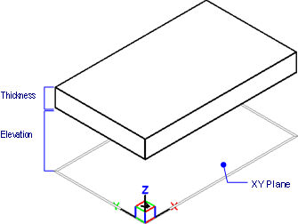

Specifies the elevation; enter a negative value for a negative elevation. The elevation is reported on the status bar as the z coordinate. The elevation is the height of the xy plane in the z direction. |
Specifies the thickness; the thickness begins at the elevation; enter negative values for thicknesses that are drawn downwards (negative z direction). The thickness is the extrusion distance (in the z direction) of non-3D entities, such as points and circles. When thickness is not 0:
