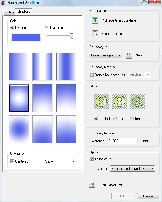

Fills closed areas with solid fills in nine different patterns and one or two colors; displays the Hatch and Gradient dialog box.
command bar: Gradient
aliases: none
menu bar: Draw | Gradient
toolbar: Draw | ![]()
: Gradient
Choose options, and then click OK.
Color Options |
One color: Click the colored tile to choose a different base color. Press and hold the left mouse button to move the slider:
Two colors: Click the colored tiles to choose a different colors. |

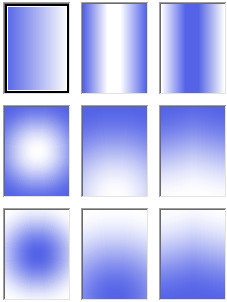

Gradient fill pattern name: Click a pattern. The options are: Linear - Cylindrical - Inverted Cylindrical Spherical - Hemispherical - Curved Inverted Spherical - Inverted Hemispherical - Inverted Curved |
Orientation: Centered: The gradient fill is created symmetrical; Not centered: The gradient fill is built up from the left of the boundary. Angle: Specifies the angle of the gradient fill, relative to the current UCS. |
Boundaries |
Specifies the closed areas (boundaries) in which to place the hatch pattern; temporarily dismisses the dialog box, and then prompts you at the command bar: Select a point to define a boundary or hatch area - pick a point inside a closed area. Notice that Bricscad immediately draws the hatch, allowing you to preview its scale factor, angle, origin, and other parameters. The prompt repeats, allowing you to choose additional areas to hatch. When done selecting areas, press Enter: Select a point to define a boundary or hatch area - press Enter to return to the dialog box. You cannot pick an area that already contains a hatch pattern, or areas that are not closed. |
Selects the entities that make up a hatch pattern boundary; temporarily dismisses the dialog box, and then prompts you at the command bar: Select entities - use any selection method to choose one or more entities. The prompt repeats, allowing you to choose additional entities. When done selecting entities, press Enter: Select entities - press Enter to return to the dialog box. This option allows you to hatch closed areas that already contain a hatch; it does not hatch open areas. |
Boundary Set |
Specifies where Bricscad should search for entities that make up the hatch boundary:
Creates a new selection set of entities that make up the pattern boundary; temporarily dismisses the dialog box, and then prompts you at the command bar: Select entities - use any selection method to choose one or more entities. The prompt repeats, allowing you to choose additional entities. When done selecting entities, press Enter: Select entities - press Enter to return to the dialog box. The next step is to click the Pick Points in Boundaries button to choose the hatch area. |
Boundary Retention |
Toggles whether boundaries are retained:
Specifies the entity used for the boundary: Polylines - makes the boundary from a polyline. |
Islands |
When a closed hatch boundary contains other boundaries, Bricscad hatches alternating areas. |
When a closed hatch boundary contains other boundaries, Bricscad hatches only the outermost area. |
When a closed hatch boundary contains other boundaries, Bricscad hatches all interior areas, as if they were not present. |
Boundary Tolerance |
Specifies the largest gap Bricscad ignores when hatching a boundary that is not fully closed. |
Options |
Toggles the associativity of hatch patterns:
Specifies where the pattern should be placed relative to other entities:
Copies the properties of another, existing hatch pattern; temporarily dismisses the dialog box, and then prompts you at the command bar: Select hatch entity to copy properties from: (Use any selection method to choose a single hatch pattern.) This button is useful for quickly setting options of a new hatch based on existing hatches. |
