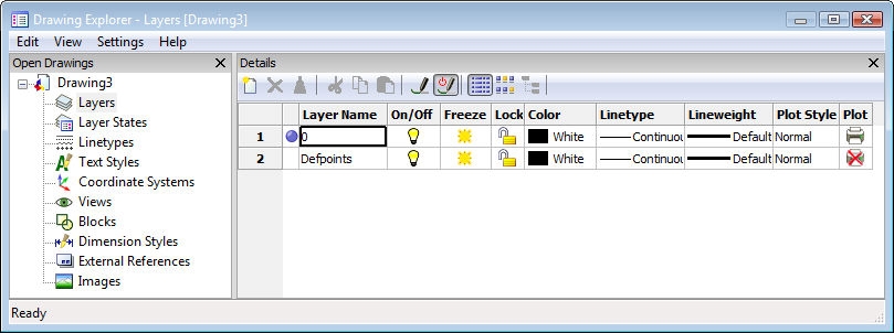

Properties
Opens the Layers section of the Drawing Explorer. See Layer command.
Layer - creates layers and changes their properties in the Drawing Explorer.
