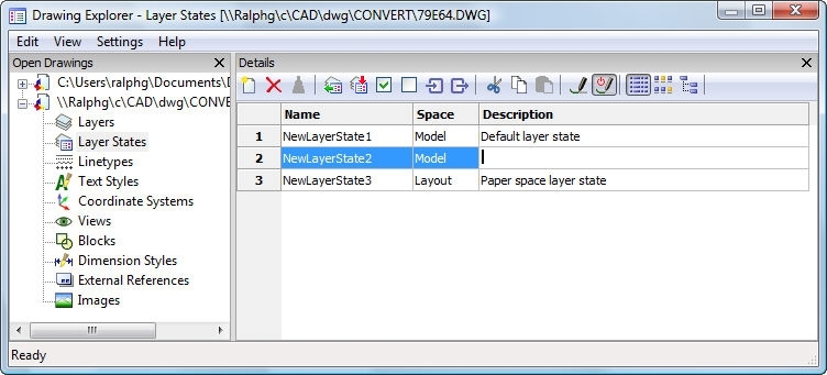

New
Creates a new layer state with the default name of NewLayerStaten.
Saves the current state of all layer properties. For example, the layer state records which layers are frozen, turned off, and locked.
Delete
Erases selected layer states.
Restore
Restores the selected layer state.
The layer properties change their state after you click X to exit the Drawing Explorer.
Save
Overwrites (saves) the current state of layers.
On
Turns on all layer properties.
Off
Turns off all layer properties.
Import
Imports layer states from LAS files.
Displays the Import Layer States dialog box.
Choose an LAS file, and then click Open.
Export
Imports layer states to an LAS file.
Displays the Export Layer States dialog box.
Name the LAS file, and then click Save.
Name
Names the layer state.
Click to rename the state.
Space
Reports which space the layer state was saved:
Model - saved in model tab.
Layout - saved in layout tab.
You must start the LayerState command in either model or a layout tab.
Describes the layer state.
