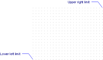

Limits the extent of the drawing and the grid.

Limits are off: ON/<Lower left corner> <0.0000,0.0000>: (Enter x,y coordinates or pick a point.)
Upper right corner <12.0000,9.0000>: (Enter x,y coordinates or pick a point.)
When limits are on, they prohibit drawing outside of the area defined by this command.
Bricscad reports, "Selected point is outside limits. Please select another point."
The area also defines the extent of the grid display, whether limits are turned on or off.

Specifies the lower left corner of the limits. |
Specifies the upper right corner of the limits. |
Grid - uses the limits to specify the extent of the grid display.
