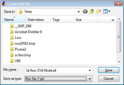

Write the plot to a file
  • Yes - plots the drawing to a PLT file.
Bricscad displays the Create Plot File dialog box.
Specify a file name, and then click Save.
