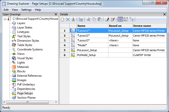

Displays the Drawing Explorer - dialog box:
Do one of the following:
Click the icon (
) of a *Layout* or
*Model* to edit the page setup of a
layout or the model space.
Click the icon of an existing page setup
definition (
) to edit a page setup.

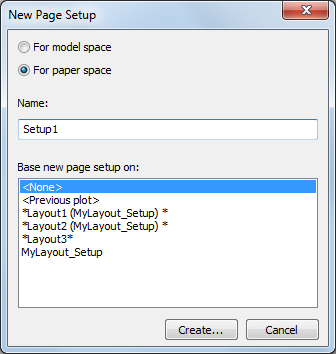

Click the New
icon (
) to create a new page setup.
When creating a new page setup you have to choose between Model space or Paper Space, then click the Create... button.

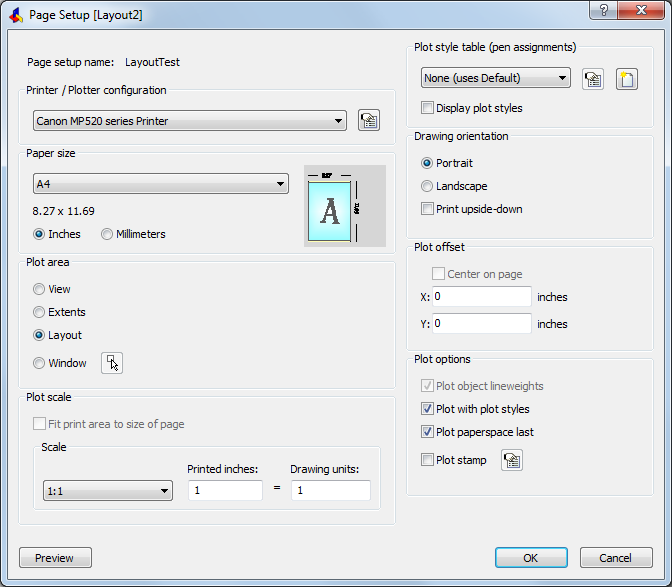

The Page Setup dialog box displays:
Choose options, and then click OK.

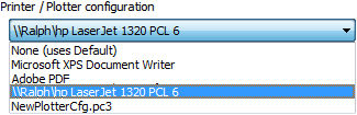

Selects the printer or plotter. Bricscad works with any output device installed on the system, including networked printers, print to file, faxes, and PostScript devices. It also uses predefined printer parameters stored in PC3 files. See PlotterManager command. |

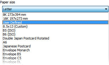

Chooses the size of paper. You can select standard sizes listed by the droplist; these are sizes supported by the printer. While printer may appear to support many different sizes, you should select only the size of paper that is actually in the printer. If User Defined appears in the list, the paper's dimensions are specified by the printer's Properties dialog box. The image indicates the size, position and orientation of the current plot area on the selected paper size. |
