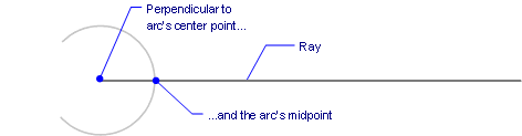

Draws a ray that bisects entities perpendicularly; prompts you: Entity/<Vertex point> - enter an option. |
Entity |
Draws rays perpendicular to the midpoint of lines and polyline segments, and the center point of arcs and polyarcs; prompts you: Select line,arc, or polyline segment to bisect - select a line, an arc, a polyline segment, or a polyarc.
When you select a line or polyline segment, Bricscad prompts you: Select side for ray bisection - choose the side on which the ray should emerge. The 'Select line,arc, or polyline segment to bisect' prompt repeats so that you can draw rays on other entities. Press Enter to exit the command. This option works with splined polylines, but not with spline entities. |

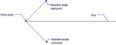

Vertex point |
Draws rays that start at the vertex point and bisect two pick points; prompts you: Bisection angle start point - specify one part of the bisection angle. Bisection angle start point - specify the other part of the bisection angle.

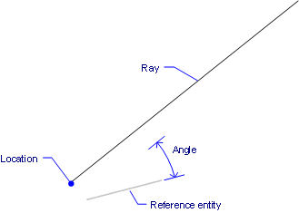

Draws rays at angles; prompts you: Reference/<Enter angle (0)> - enter an option. |
Reference |
Draws rays at an angle relative to another entity; prompts you: Select reference entity - choose a line. The line provides the reference (base) angle. Enter angle - specify the angle, measured relative to the entity. Location - specify the angle's start point; need not coincide with the entity's end points.
The 'Location' prompt repeats for drawing multiple rays at the same angle. |
