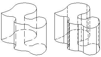

Hide tangential edges? |
A tangential edge is the transition line between two tangent faces. It is an imaginary line between the two faces. In most cases tangential edges need to be removed.
Tangential edges removed (left) - tangential edges displayed (right). Tangential edges are removed. Tangential edges display. |
