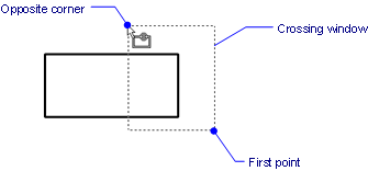

Select entities to stretch by crossing-window or crossing-polygon: (Pick a point, or enter C or CP.)
Opposite Corner: (Pick another point.)
This command works only with crossing selection modes.
Entities in set: 1
Select entities to stretch by crossing-window or crossing-polygon: (Choose more entities, or press Enter to continue.)
Base point of displacement: (Pick a point, or enter x,y coordinates.)
Second point of displacement: (Pick another point.)
Text cannot be stretched.
Selects the entities to stretch; must use Crossing or Crossing Polygon mode:
  • C - crossing mode.
  • CP - crossing polygon mode.
When using the cursor, pick the second point to the left of the first:
Crossing mode is indicated by a dashed selection rectangle.

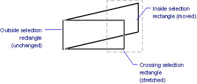

The selection rectangle (or polygon) determines how this command affects entities:
  • Entities crossing the selection rectangle are stretched.
  • Entities within the rectangle are moved.
  • Entities outside the rectangle remain in place.
