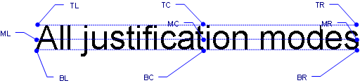

Justify
Displays all justification modes; prompts you:
Text: Style/Align/Fit/Center/Middle/Right/TL/TC/TR/ML/MC/MR/BL/BC/BR/<Start point> - enter an option.
  • TL - top left
  • TC - top center
  • TR - top right
  • ML - middle left
  • MC - middle center (equivalent to Middle).
  • MR - middle right
  • BL - bottom left (equivalent to Start Point).
  • BC - bottom center (equivalent to Center).
  • BR - bottom right (equivalent to Right).

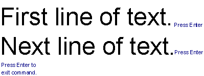

Text
Specifies the text.
Enter a line of text, and then press Enter.
The prompt repeats; enter more text.
Each additional line of text is positioned under the previous line.
Exit the command by pressing Enter at the 'Text' prompt.

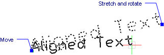

Grips Editing
Text can be moved directly through grips:
  1. Select the text face. Notice that it has one grip at its insertion point.
  2. Drag the grip to move the text.
Aligned and fitted text have two grips:
