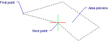

As you pick points, Bricscad previews the area with a dashed polygon.
Use entity snap modes to ensure your picks are accurate.
When done picking points, press Enter; Bricscad reports the area and perimeter like this:
Area = 6.1836 sq. units, Perimeter = 11.2968

First point
Specifies the first point of the area to be measured. The prompt changes to:
<Next point> -pick another point, or press Enter to end the area specifying.
