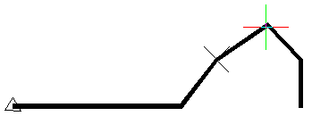

Break
Removes segments from the polyline; prompts you:
Next/Previous/Select/Go/eXit/<Next> - enter an option.
Bricscad marks the two vertices that define the segments to be removed with two X markers.
Next
Moves the second X marker to the next vertex.
Previous
Moves the second X marker to the previous vertex.
Select
Moves second X marker directly to another vertex; prompts you:
Select point along segment move to - pick a point on the polyline.
Bricscad places the second X marker on the vertex nearest to the pick point.
This option is faster than using Next and Previous.
Go
Erases the segments between two marked vertices.
This action turns:
  • Closed polylines into open polylines.
  • Open polylines into two polylines, with a gap between them.
This action cannot be undone.

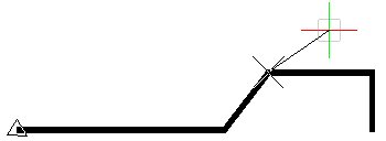

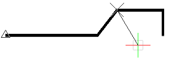

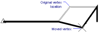

Move
Moves the current vertex; prompts you:
New location for vertex - pick point to move the vertex.
The drag line previews the new location of the vertex.
Bricscad moves the vertex and associated segments.
It is easier to move vertices using grips.
