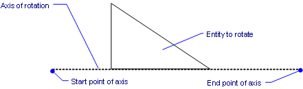

2 points
Specifies the start point of the axis of rotation.
Specify the second rotation axis point
Specifies the endpoint of the axis of rotation.
