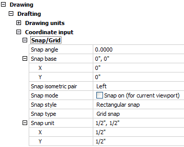

Settings
Opens the Snap/Grid section of the Settings dialog box.
Snap angle
Sets the angle of the snap in the current UCS.
Also affects the angle of the grid display and ortho mode.
Snap base
Specifies the x,y-coordinates about which the snap rotates.
Snap isometric pair
Specifies the isometric plane; click the droplist and choose one:
  • Left - left isometric plane.
  • Top - top isometric plane.
  • Right - right isometric plane.
This setting requires Snap Style to be set to Isometric Snap.
Snap mode
Toggles snap mode:
  • On - turns on snap.
  • Off - turns off snap.
Snap style
Specifies the snap style; click the droplist and choose one:
  • Rectangular snap - regular snap mode.
  • Isometric snap - isometric mode.
Snap type
Specifies the snap type; click the droplist and choose one:
  • Grid snap - uses distances along the x and y axes.
  • Polar snap - uses relative distance and angle.
Snap unit
Specifies the snap increment distance:
  • X - spacing in the x direction.
  • Y - spacing in the y direction.
There is no snap in the z direction.
