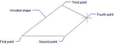

Rectangle/Square/Triangle/<First point of plane>: (Pick a point, or enter an option.)
Second point: (Pick another point.)
Third point of plane: (Pick another point.)
Fourth point: (Pick another point to draw a quadrangle, or press Enter to draw a triangle and exit the command.)

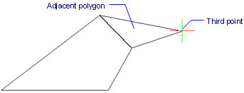

Third point of plane: (Pick another point to draw an adjoining triangle, or press Enter to exit the command.)

Second point
Specifies the second corner of the polygon.
Bricscad ghosts the shape and size of the polygon.
Third point on plane
Specifies the third corner of the polygon.
Fourth point
Specifies the fourth corner of the polygon.
To draw a triangle, press Enter at the prompt.
Starts drawing an adjacent polygon.
The third and fourth points of the first polygon become the first and second points of the second polygon.
To end the command, press Enter at the this prompt.

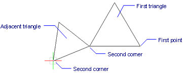

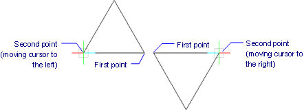

Triangle
Draws one or more connected scalene triangles.
Specifies one corner of the triangle.
Pick a point, or enter x,y coordinates.
Second corner of triangle
Specifies the second corner of the triangle.
Cursor movement determines the orientation of the triangle. Move cursor to the:
  • Right - triangle is drawn upside down.
  • Left - triangle is drawn rightside up.
The "Second corner of triangle" prompt repeats to draw additional triangles.
