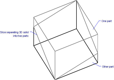

Specify a point on desired side of the plane or Both: (Choose one of the parts; the other one is erased. Or type B to retain both.)

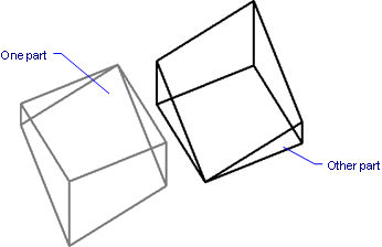

The sliced solid can be separated and its two parts manipulated as independent entities:

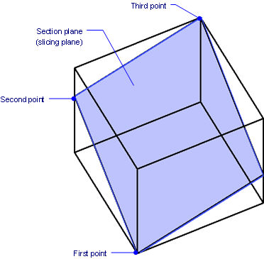

Specify first point on section plane
Specifies the first of three points that define the slicing plane.
Pick a point or enter x,y,z coordinates; prompts you:
Specify second point on plane - pick another point.
Specify third point on plane - pick a third point.

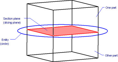

Object
Slices the 3D model with an entity that intersects the 3D solid; prompts you:
Select a circle, ellipse, arc, 2D-spline, or 2D-polyline - choose an entity.
You can also use elliptical arcs.
The entity defines the plane that slices the 3D solid.

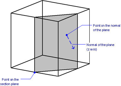

Zaxis
Slices the 3D model with a plane defined by one point on the plane, and a second on the plane's normal (z axis); prompts you:
Specify a point on the section plane - pick a point to define the location of the section plane.
Specify a point on the Z-axis (normal) of the plane - pick another point to locate the normal.

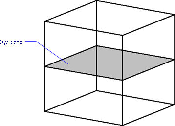

XY
Slices the 3D model with a plane parallel to the x,y plane; prompts you:
Specify a point on the XY-plane - pick a point to define the height of the slicing plane above or below the x,y plane.

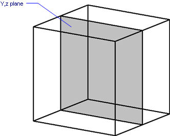

YZ
Slices the 3D model with a plane parallel to the y,z plane; prompts you:
Specify a point on the YZ-plane - pick a point to define the height of the slicing plane above or below the y,z plane.

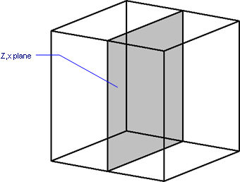

ZX
Slices the 3D model with a plane parallel to the z,x plane; prompts you:
Specify a point on the ZX-plane - pick a point to define the height of the slicing plane above or below the z,x plane.
Specifies which of the two portions to keep.
Or type B to retain both parts.
