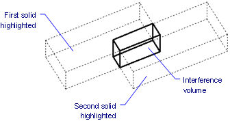

Create interference solids?
Determines whether a solid or region of the interference is created:
  • Yes - creates a solid of the interference volume or region of the interference area.
  • No - does not create solids or regions of the interference.
The solid or region remains after the command ends.

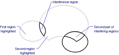

Highlight pairs of interfering solids?
Determines whether solids or regions are highlighted:
  • Yes - highlights the solids and/or regions that interfere with each other.
  • No - does not highlight the entities.
Enter an option
Steps through pairs of interfering solids or regions.
Next pair
Press Enter to show the next pair of entities that interfere with each other.
