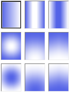

Gradient fill pattern name: Click a pattern. The options are: Linear - Cylindrical - Inverted Cylindrical Spherical - Hemispherical - Curved Inverted Spherical - Inverted Hemispherical - Inverted Curved |
