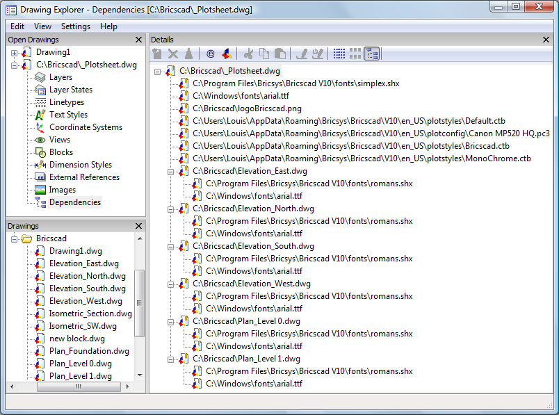

The Drawing Explorer dialog opens the Dependencies category is selected:
Click the eTransmit
button (
) in the Details toolbar.
The eTransmit dialog
opens:
By default all dependencies are selected to be
included in eTransmit.
Click a checkbox to remove a file. Click again to add a file.

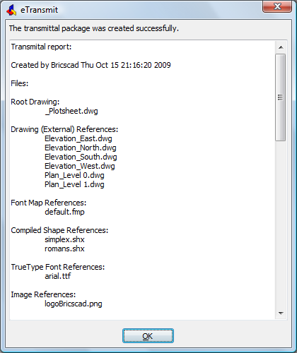

Click the Transmit
button.
The eTransmit report window displays.
Click the OK button to close the
report window.
