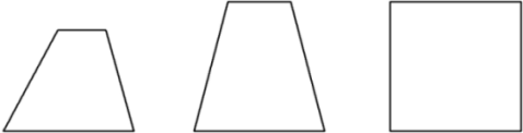

Transformation refers to the calculation of the points on the
screen that correspond to points you digitize on the tablet.
Orthogonal (left): To be used with accurate paper drawings. Orthogonal transformation maintains all angles and preserves relative distances. If only two calibration points are specified orthogonal transformation is generated automatically.
Affine (middle): Maintains parallel lines, but not necessarily the angles between intersecting lines.
Projective (right): Does not maintain parallel lines, nor angles.
