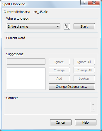

  1. Open the Spell Checking dialog.
  2. (option) Click the Select button () to compose a selection set.
  3. (option) Change the current dictionaries.
  4. Click the Start button ().

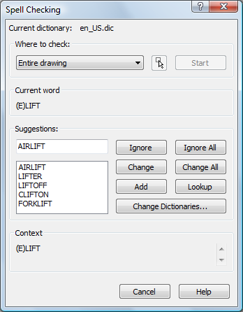

The first possibly misspelled word displays in the Current word section.
The content of the text entity in which the Current word is found displays in the Context section.
  1. Do one of the following
  2. Click the Ignore button () to leave this instance of the Current word unchanged.
  3. Click the Ignore All button () to leave all instances of the Current word unchanged.
  4. Accept the word in the Suggestions field or select a word in the Suggestions list, then click the Change button () to replace this instance of the Current word by the word in the Suggestions field.
  5. Accept the word in the Suggestions field or select a word in the Suggestions list, then click the Change All button () to replace all instances of the Current word by the word in the Suggestions field.
  6. Click the Add button () to add the Current word to the current custom dictionary.
  7. Click the Lookup button () to list words similar to the word in the Suggestions field.

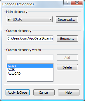

  2. Click the Change Dictionaries... button ().
The Change Dictionaries dialog opens.
  1. Click the Main dictionary list button to change the main dictionary.
  1. Select a new main dictionary.
  2. (option) Click the Browse... button to select a new Custom dictionary.
  3. (option) Type a word in the Custom dictionary words field, then click the Add button to add a word to the current custom dictionary.
  4. Click the Apply & Close button.

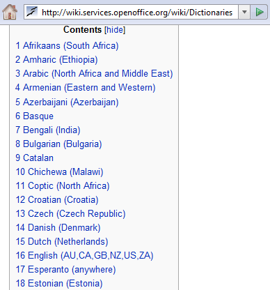

Your browser opens: http://wiki.services.openoffice.org/wiki/Dictionaries
  1. Do one of the following:
  2. If necessary, click show next to Contents to display the list of available dictionaries.
    Click the language you want to download the dictionary for.

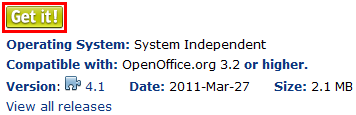

  1. Go to the Extensions Repository to get the new dictionaries.
Scroll down to the language of your choice, then click the link to open the page of the selected language.
Click the Get it! button to start downloading the *.oxt file.
Change the oxt extension to zip.

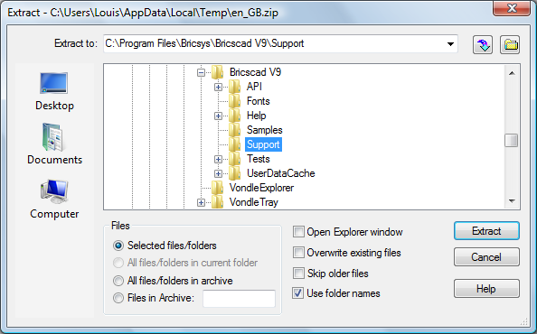

  1. Extract the *.aff and *.dic files in the ZIP file to the C:\Program Files\Bricsys\Bricscad Vx\Support folder.
The dictionary is now available in the Main Dictionary list on the Change Dictionaries dialog box.
