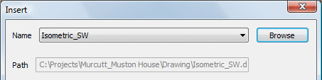

To reload an external drawing as a block
Do one of the following
Click the Insert
Block... tool button (
) on the Draw 2D
toolbar.
Choose Insert Block... in the Draw menu.
Type insert in the command bar, then press Enter.
The Insert Block dialog opens.
On the Insert Block dialog click the Browse, then select the external drawing file.
Click the Insert
button.

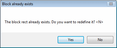

An Alert box displays.
Click the Yes button
to redefine the existing block definition.
The command bar reads: Insertion point for block:
Continue with step 3 of the Inserting Blocks procedure.
