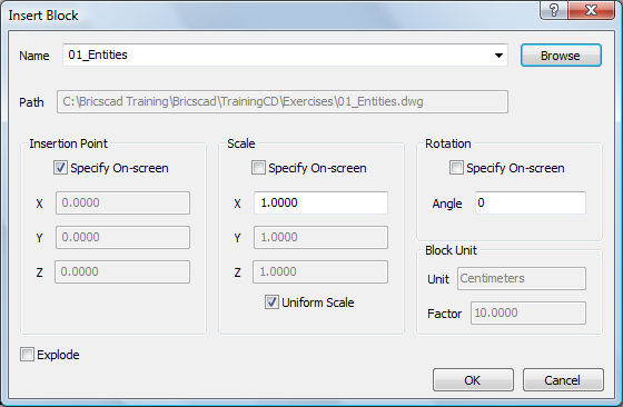

  4. Type insert in the command bar, then press Enter.
The Inserts dialog opens.
  1. In the Inserts dialog, do one of the following:
  2. Select an existing block definition in the Name list.
  3. Click the Browse button and select a drawing file.
  1. (option) Check the Explode option to explode the block after insertion.
  2. (option) Uncheck the Specify On-Screen option, then specify the Insertion Point by keying in the coordinates in the X, Y and Z fields.
  3. (option) Uncheck the Specify On-Screen option, then specify the Scale by keying in the scaling factors in the X, Y and Z fields.
    Check the Uniform Scale option to equal the X, Y and Z scale factors.
  4. (option) Check the Specify On-Screen option to specify the Rotation angle when inserting the block.
  5. Click the OK button.
