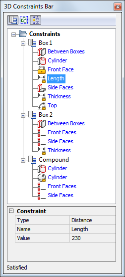

Displays the 3D Constraints bar.
command bar: dmconstraintsbar
menu bar: Parametric | 3D Constraints Bar
toolbar: 3D Constraints | ![]()
: dmConstraintsBar
By default the 3D Constraints bar is docked a the right hand side of the Bricscad application window, below the Properties bar.
Icon |
Groups the 3D constraints by entity (body). |
Groups the 3D constraints by constraint type. |
Sorts the 3D constraints alphabetically. |
Current name of the entity (body). |
Current value of a dimensional constraint. Click the field to edit. |
Context Menu
Right click a constraint, then click Delete to delete the constraint. |
