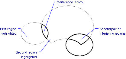

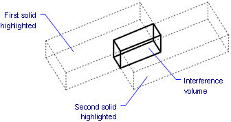

Create interference solids?
Determines whether a solid or region of the interference is created:
  • Yes - creates a solid of the interference volume or region of the interference area.
  • No - does not create solids or regions of the interference.
The solid or region remains after the command ends.
Highlight pairs of interfering solids?
Determines whether solids or regions are highlighted:
  • Yes - highlights the solids and/or regions that interfere with each other.
  • No - does not highlight the entities.

Steps through pairs of interfering solids or regions.
Next pair
Press Enter to show the next pair of entities that interfere with each other.
