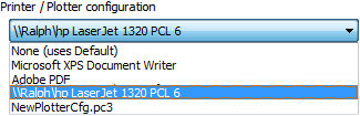

Selects the printer or plotter.
Bricscad works with any output device installed on the system, including networked printers, print to file, faxes, and PostScript devices.
It also uses predefined printer parameters stored in PC3 files. See PlotterManager command.
Edit plotter configuration
Opens the printer's Properties dialog box for customizing the printer's parameters.
