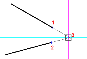

To snap to the extension of two entities
If not already on, turn on the Extension Entity Snap mode ().
Launch a drawing tool, e.g. Draw Line.
Move the cursor over the endpoint of the first
entity (1).
A small cross () indicates the entity is
marked for extension.
Move the cursor over the endpoint of the second
entity (2).
Move the cursor near the intersection of the
extensions of the two entities.
An X indicates the intersection (3).
Click to accept the snap point.
